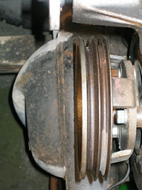

| The custom spacers are just seen on the far right, behind the pulley. They hold the pulley out from the harmonic balancer about 7/16". The pulley goes on tight but it wobbles slightly. I reworked this setup a few months after I built it, but it still isn't perfect. |
