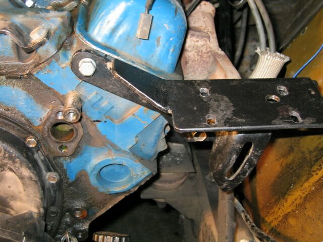

This bracket anchors the outboard end of the steering pump (curved, slotted part on the bottom), and provides a platform for the York air compressor. With 2 bolts to the head and 2 more to the exhaust manifold, it's hell for stout.
