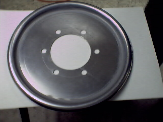

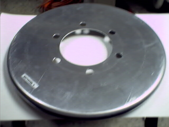

taken a couple photos of the new design and am forwarding them to Woody
for
inclusion on the www.ih8mud.com website along with the installation
instructions. Hopefully they will be up for viewing in a few days for
those
who are interested.
