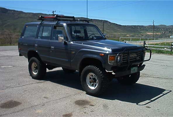

Click on picture for full size image.  A 60 series Land Cruiser with a spring over axle conversion
that was done as small as possible.  This 60 series sits on 33x12.5 Good Years.
