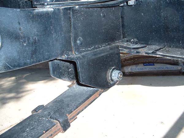

SOA, make your own or buy a hanger. Proffitt’s Cruisers (www.proffittscruisers.com)
carries a good bolt on spring hanger that will make the proccess a whole
lot easier. Here is an excellent example of Kurt Williams (Cruiser
Outfitters) front spring hanger which he made himself:
**One thing to note though, is that if you do a shackle reversal, do it BEFORE you measure your front axle for a cut and turn, because a shackle reversal designed for a SOA rig will have different measurements than if it retains the stock shackle postion. Next page:
