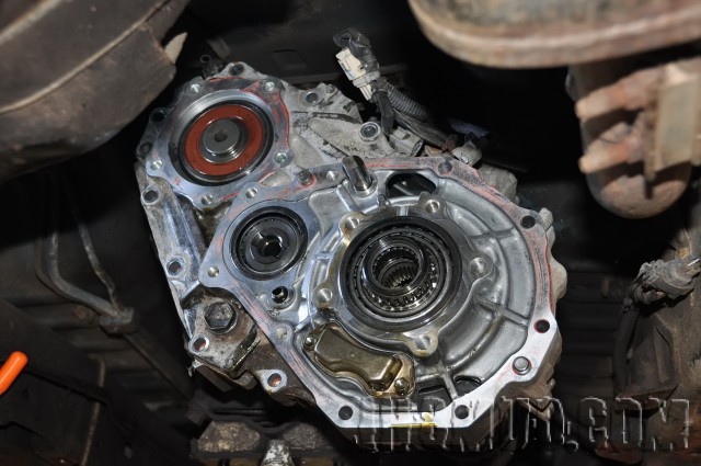

The Marlin Crawler kit supplies one differential low speed gear and one idler low speed gear. Those two gears, combined some cut-off wheel/grinder time, silicone, thread sealant and fresh gear lube, makes for a very simple shade-tree installation. The transfer case does NOT need to be pulled from the vehicle, and even the front driveshaft remains installed. The hardest part of the whole process is separating the gearset using a shop press and the careful trimming/grinding that’s done inside the transfer case.
Assembly is simple enough…Marlin provides an excellent set of directions on their website. Gear lube, silicone and thread sealant are the basic, and an assortment of tools.
