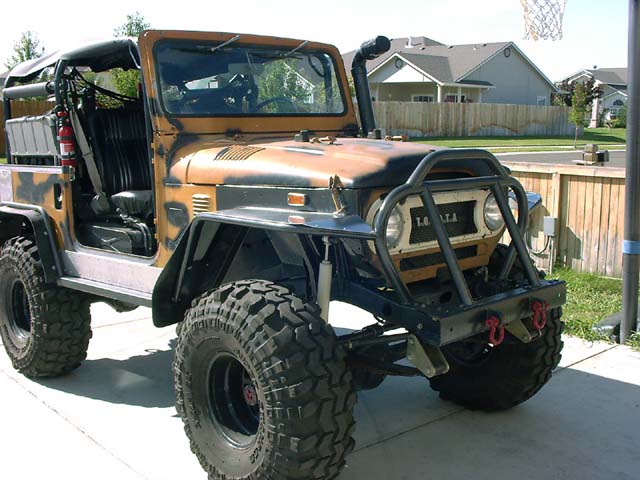

I’ve run Optima Performance Batteries for many years. The reasons are simple: safety and quality. The batteries I’ve owned have lasted beyond their expected life and warranty period, and the AGM (Absorption Glass Mat) design is an added safety factor when it comes to potential rollovers (which I’m known for). I currently run a single RedTop in my 1974 FJ40 Toyota Land Cruiser and a pair of RedTops in my 1996 FZJ80 Toyota Land Cruiser.
